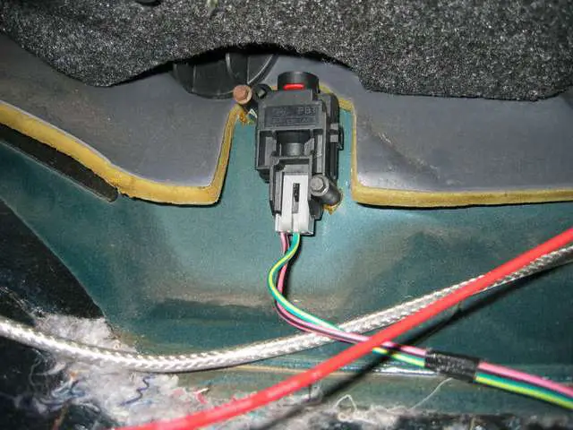

When you turn the key to run (not start) can you hear the fuel pump prime for a few seconds? If not then get a multi meter and test the fuel pump inertia swtich to see if it is getting any power.. When priming the fuel pump both wires should read 12v (but only for 2-3 secs max). After that the power will step down to ~7 volts (see and search on related threads Fuel pump not working)
