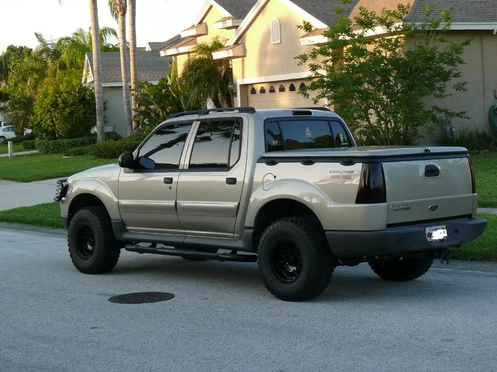

Here's a breakdown of what I've done to my '03 ST 4wd XLT:
Started stock:
(lost photos)
Then the new 265/7016 Bridgestones Dueler APT II's:
Then I did the Warrior Products lift shackles and 1.75" Torsion Twist up front:
Next came the 3" performance Accessories body lift and 285/75/16 BFG T/A K/O'sand 1.5" wheel spacers:
I have these new wheels and tires but waiting 'til I get in the garage and install new upper/ lower ball joints, etc. and get an alignment done before I install them. Their 15x8 Cragar Soft 8's with 33x12.50x15 Goodyear DuraTrac's:

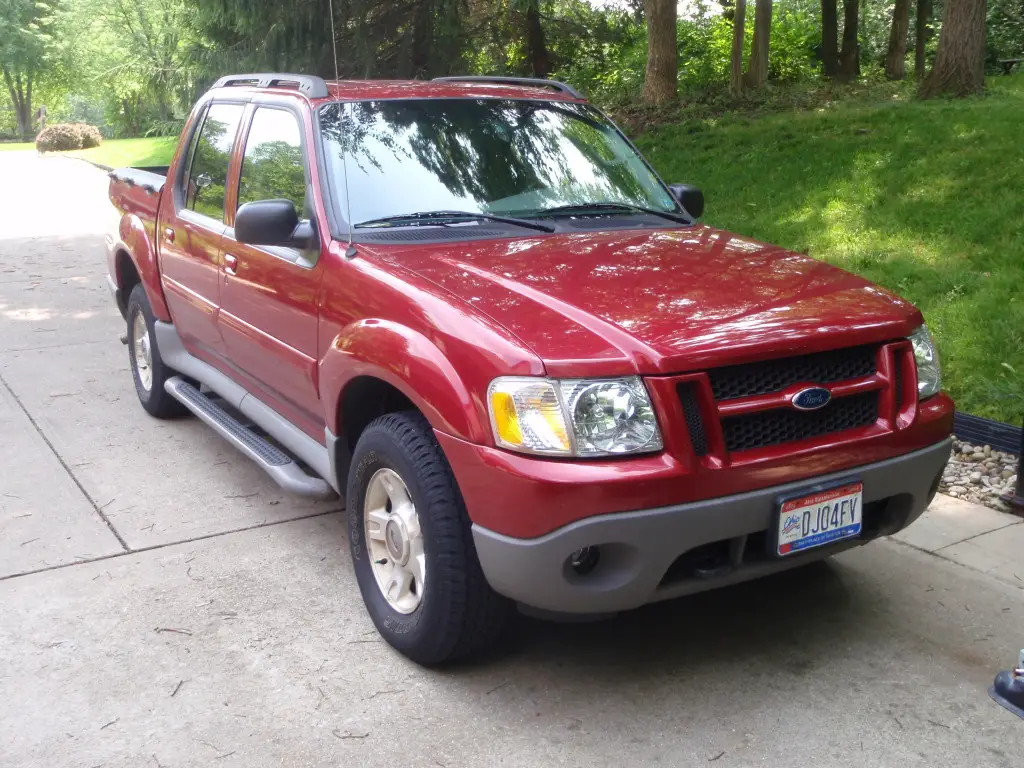

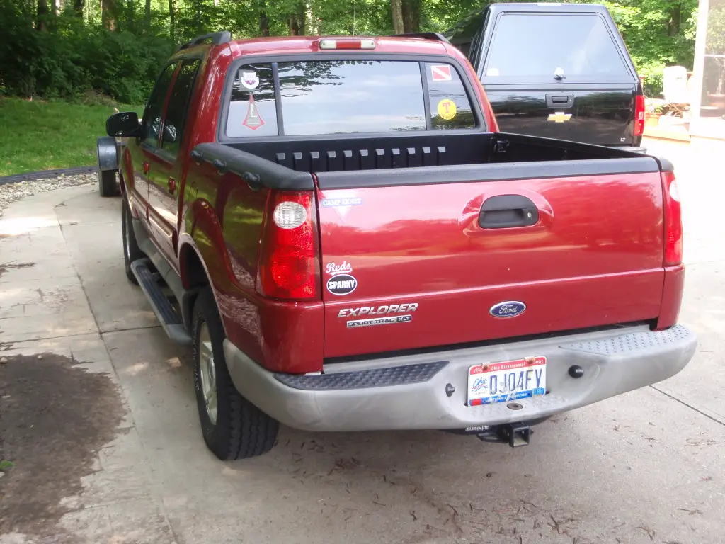

I never posted pics of "Red Trac" you may think the name is lame, but it's what she got!
