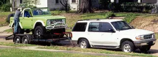

Is this a option?? Its a 95 with a 6banger that moves. I wanted to tow a 03 malibu wakesetter 23ft. It has brakes. How about an offroad built Early bronco up to the trails on a flat bed??
BTW the X is my girlfriends.
How about hitchs?? Just toss a drawtight and call it good??
Thanks
Andy
Hell.. if its your girlfriends.. tow whatever you want! :D
But you should definitely be able to tow the boat.. especially with brakes. If you'll be towing the EB long distances you might want to think about brakes on that.
I'd suggest getting a tranny cooler if you will be towing often or long distances. And yeah, throw on a draw tite class III or better. You'll be good to go!
i have the 5 liter and i can tow my early bronco. it doesnt like it much, but it will pull it. ;) i would really really hate to try to tow something like this with the V6... it may work, just make sure you NEVER use overdrive.
as long as the trailers have their own brakes as well, and you arent trying to tow something super heavy or with too huge a tongue wieght, you should be fine.......
my 94 towed my 85 grand marquid 4 door just fine, just had to make sure I had plenty of stopping distance.
