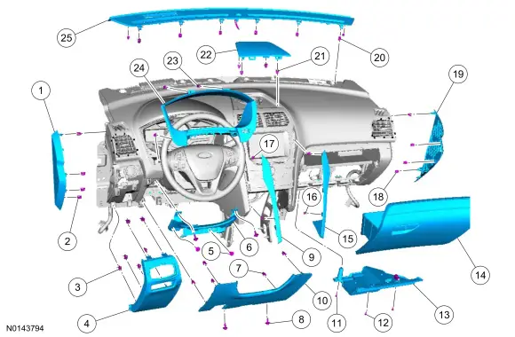

I thought I read somewhere where you have to carefully pull the silver side trim forward and off, then pull the center console forward and buff as well. I think the silver trim pieces might cover a few screws.
2012 Explorer
501-12 Instrument Panel and Console REMOVAL AND INSTALLATION
Instrument Panel - Exploded View
ploded View
Instrument Panel
Item Service Part Number Description Torque Material Name Notes
7804480
LH instrument panel side trim panel
2
W790172
LH instrument panel side trim panel clip (4 required)
3
W705289
Lower LH instrument panel trim panel clip (6 required)
4
7804338
5
N807316
Steering column cover assembly screw (4 required)
5 Nm (44 lb-in)
6
78017A26
7
W705289
Steering column cover trim panel clip (4 required)
8
W707628
Steering column cover trim panel screw (2 required)
1.9 Nm (17 lb-in)
9
78061A17
LH finish panel
10
7804459
11
W707607
Instrument panel insulator screw (1 required)
2.5 Nm (22 lb-in)
12
W707628
Instrument panel insulator screw (2 required)
2.5 Nm (22 lb-in)
13
78046A24
14
7806024
Glove compartment
15
78061A16
RH finish panel
16
W705289
RH finish panel clip (4 required)
17
W705289
LH finish panel clip (4 required)
18
W790172
RH instrument panel side trim panel clip (4 required)
19
7804481
RH Instrument panel side trim panel
20
W790172
Defroster grille clip (6 required)
21
W790172
Speaker grille clip (4 required)
22
18978
Speaker grille
23
78044D70
Instrument cluster finish panel
24
W705289
Instrument cluster finish panel clips
25
78044E82
Defroster grille
Glove Compartment Close Out
W707628
Glove compartment close out panel screw (8 required)
1.9 Nm (17 lb-in)
2
7804338
3
W790172
Glove compartment close out panel clip
4
7806200
Glove compartment dampener
5
W506824
Glove compartment dampener screw (2 required)
0.8 Nm (7 lb-in)
Instrument Panel Fasteners
W709268
Instrument panel-to-floor bolt (4 required)
25 Nm (18 lb-ft)
2
W710259
Instrument panel-to-body bolt (6 required)
40 Nm (30 lb-ft)
3
W709178
RH instrument panel-to-front of dash bolt
25 Nm (18 lb-ft)
4
W709178
LH instrument panel-to-front of dash bolt (2 required)
25 Nm (18 lb-ft)
5
W712961
Steering column shaft-to-steering column bolt
23 Nm (17 lb-ft)
6
14401
RH electrical connector
7
14401
LH electrical connector
Front Controls Interface Module (FCIM)
Exploded View
Item Service Part Number Description Tool Number Material Name Notes
W707628
FCIM screws (4 required)
2 Nm (18 lb-in)
2
18842
FCIM
3
FCIM electrcial connector (part of 14401)
Removal
1.Remove the LH and RH finish panel. REFER to Instrument Panel - Exploded View.
2.Remove the 4 FCIM screws.
• To install, tighten to 2 Nm (18 lb-in).
3.Pull back on the FCIM starting at the bottom and working to the top to release the clips and remove the FCIM.
1.Disconnect the electrical connector.
Installation
1.To install, reverse the removal procedure.
Audio Control Module (ACM)
Exploded View
W707628
ACM screws (4 required)
2 Nm (18 lb-in)
2
18C869
ACM
3
ACM electrical connectors (part of 14401)
Removal
1.NOTE: If installing a new module, it is necessary to upload the module configuration information to the scan tool prior to removing the module. This information must be downloaded into the new module after installation.
Upload the ACM configuration information to the scan tool by following the scan tool on screen instructions.
2.Remove the FCIM. REFER to Front Controls Interface Module (FCIM).
3.Remove the 4 screws and the ACM.
1.Disconnect the electrical connectors.
Installation
2.Download the ACM configuration information from the scan tool to the new ACM following the scan tool on screen instructions.
Front Display Interface Module (FDIM)
Exploded View
W707628
FDIM screws (4 required)
2 Nm (18 lb-in)
2
18842
FDIM
3
FDIM electrical connector (part of 14401)
Removal
1.Remove the FCIM. REFER to Front Controls Interface Module (FCIM).
2.Remove the 4 screws and the FDIM.
Installation
