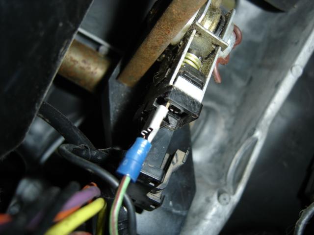

The Switch on the pedal arm, unfortunately in my case a wire broke off completely. So i just flipped the connector around and crimped a new end on the broken wire.

Explorer/Ranger Brake Light Broken Wire...
My 93 Ranger XLT :rangertan: had the exact same problem. I noticed something was wrong when cruise control would not disengage depressing the brake pedal. A bit scary. Same as above, one broken wire. I unplugged the socket from the switch and pried it apart with a small flat-head screwdriver. I have a pack of right-angle connectors from AutoZone item # 84171 for 16-14 gauge wire. I cut off the connectors light blue insulator and found it fit right in place of the original one. It does protrude just a tiny bit after the socket is reassembled but isn't a problem. Plugged it back in and all is well again. :D
