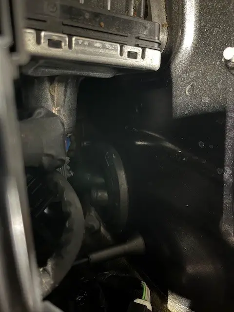

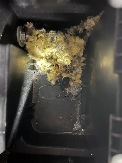

Still working it, but here are pics of a nest in the car. The said they use peanut oil based plastic insulation on the wires. Makes great sense.
