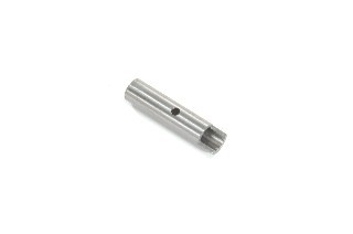

It's a good idea to install a manual index sleeve: http://www.transmissionpartsusa.com/A4LD_Manual_valve_index_sleeve_p/400-005694701.htm.
This link explains more about it: http://www.sonnax.com/instructions/56947-01-IN.pdf. This link is # 31 in my list of useful threads: http://www.explorerforum.com/forums/showthread.php?t=155599. It explains a little more about the Z link. The links in # 19 in my list of useful threads explain how to make linkage adjustments.
