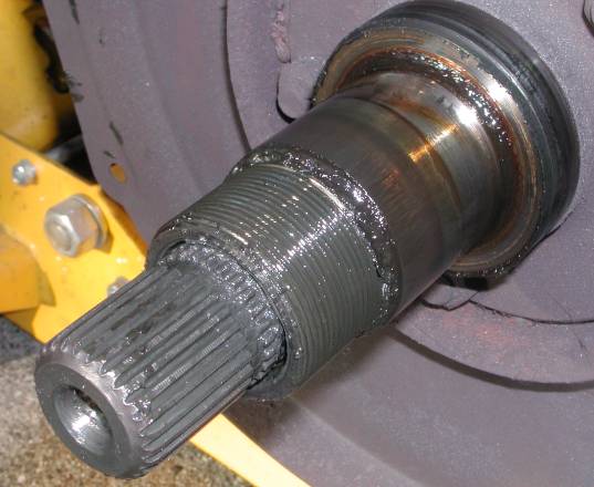

So the noise was a couple different things. The main one definitely being the passenger outer wheel bearing, the top cap of the bearing had broken apart and all the scraps were rolling around in the hub. And along with that, the brake pads had very little pad left over with, causing a very loud grinding noise.
So we took it to Les Schwab and they said that she needed new bearings, pads, and rotors. I knew it needed bearings and pads, and the rotors were pretty low, so I figured they might as well do it while they are in there.
But we got a call later on saying that it needed a new "spindle", and that they would have to contact Ford to figure out how to get it. Is this a common part to break, are there easier/less expensive ways to get it (rather than through Ford/Les Schwab)? Or are they just trying to pull the wool over our eyes and get us to spend our money?
And if I didn't previously mention it, this is regarding the front hub set-up on a 92 4wd explorer.
As I mentioned in my post if your wheel bearings fall apart they can easily fubar the spindle. The surface should be smooth without any scratches, pits etc.. The cheapest fix is to go to a bone yard and pull one off a junked 1st gen 4x4.
