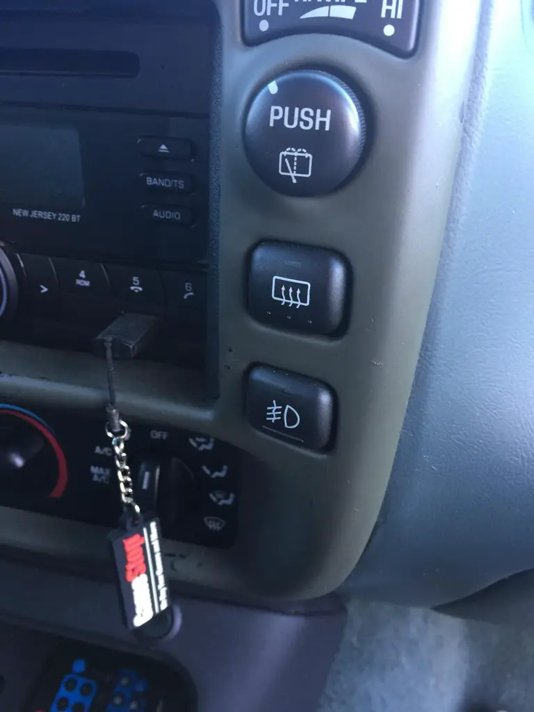

Hey sthmstr. I took some pity on you and ventured out to the driveway for some pics:
Here's where the OE fog light switch goes, on the radio surround:

Thanks so much for the pics 96Green and the suggestions, Toypaseo. Here's a few pics(if i loaded them correctly). My understanding is that the vehicle should be prewired, but maybe there's a jumper of sorts that I'm missing.

I'm not sure which plug you are referring to, but, I can guarantee it is not related to your foggies. The only switch connector for the front fog lamps is grey & yellow, not blue.

Went to the junkyard on lunch. Confirmed the plug in question is definitely not for the fog lights. on the model I found it connected to some sort of a control module mounted on the dash support frame. Custom wiring it will be. Thanks just the same for the help.
