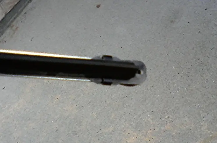

Attempted to install the Trico on the rear wiper arm, but the hump over the side post hole was too high. Plan B. Swapped the wiper's insert, and metal support rib. Perfect fit, but the Trico's end clip would not allow the insert to snap into place. It was close. I think if you would flatten the very end so the OEM wiper blade could slide past, it would work. The end clips just slide on, so I just swapped clips. Now, the insert snaps in place like the OEM one.
Haven't tried the wiper yet, but if there are any issues, I will post them up.
Trico blade frame top, Trico insert in OEM blade frame bottom:
OEM insert clip left, Trico insert clip right:
Trico clip not allowing insert to snap in place:

So far, works great :thumbsup: Full contact across the whole swipe :thumbsup:
OEM clip installed
Full view with OEM clip installed
