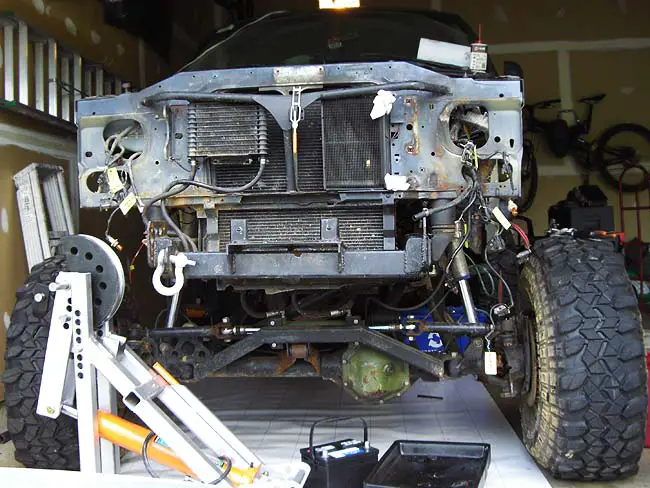

In this picture, there are two coolers mounted in front of the radiator. If it looks like any of these (either as its pictured or rotated 90 degrees), then it is the cooler for the transmission. Since you have a 94 Explorer, then you probably have one that looks like the one on the driver's side except rotated 90 degrees (the one that has its ports wrapped with paper towels).
Oh, well I only have the one on the drivers side. Should I have the both of them? Is it that important or would it just make it better?

No you are only supposed to have one - I had two because the other one was for the full-hydraulic steering.
