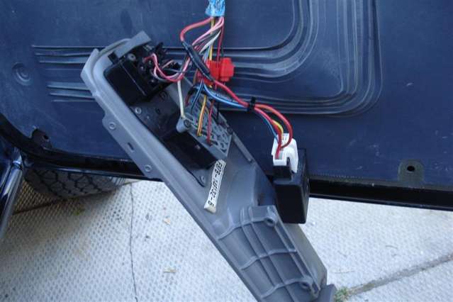

1st gen explorers, and some taurus's around the 96-00 range if i am not wrong had a modual in them for one touch down.
they look like this (the black box with the big white connector on it)
there is a write up on how to put them in here
http://www.explorerforum.com/forums/index.php?threads/passenger-side-one-touch-window-down.141027/
BUT what you do is instead of hooking it to the wire that controls the motor going down, you put it on the wire that controls the motor to go up from the switch. same thing, you would need one for each window you would want to do this to. also, if you go to a wrecker and find one, and the connector, you can probably get them way cheaper then buying a kit. these will work in ANYTHING. i have these in both my 98 explorer, and my 07 ranger.
