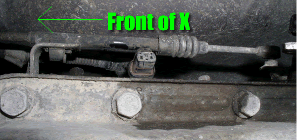

I lost overdive after a service once....Turned out somebody forgot to plug in a harness on the side of the tranny:D Maybe yours loosened off.
That'd be sweet...Not that someone left it off, but it that's all it took to fix it. Sounds like something that would happen to me too, go through all this trouble and it ends up being a harness unplugged, hehe, I'll have to check them out tomorrow...

Hey Crankcase, is this what the wire harness looked like?
I think I might have taken care of this problem :D

HA! It WAS the plug? EF saves yet another tranny bill!:D :thumbsup:
