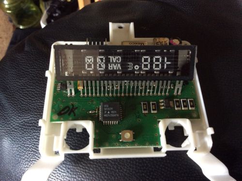

There are actually two designs, I assumed there was one before I took mine apart. I have the earlier one on the left. I think 98+ has the newer design, which tends to have the resistor issue. The newer design definitely cost less and minimizes components. The compass sensors are also solid state.

Those two look fairly interchangeable, the shape and dimensions I mean. Can you tell if they really are to the extent that people could choose either one as a replacement?
They are essentially the same. There is a bit of difference in how the boards and displays are mounted.
