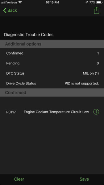

So she overheated on the way home from work
Turned the air on hot to bleed some heat bad that didn’t seem to blast any heat?
There is a crack in the radiator that was dripping,
But also there was a high pressure squeal that sounded farther back near the ac on the passenger side of the engine?
Thinking thermostat and thermostat housing?
Reservoir is plenty full
