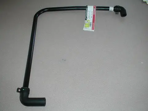

If your 99 4.0L SOHC is the same as a 01 4.0L SOHC you'll find the front PCV elbow to be cracked and causing your problem. If yours is like this photo then check it before you tear stuff apart. The crack will be on the bottom, that's on the lower hose.
KCV190 Motorcraft

By the way ncranchero, I couldn't find the hose from the picture. Where around the splash shield is it?
Splash shield ??? What you're seeing in the photo is the radiator hose, MAF cover and corner of the intake manifold ........ If you just replaced the intake gaskets and didn't see the hose then yours must be different from the '01.
the pcv elbow should be in the same place on a 99, and is a very common problem. If you dont replace the broken bolt it will at a minimun create a problem down the road.
