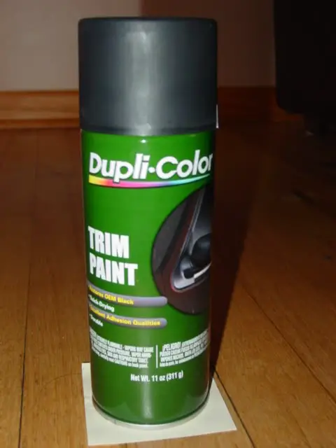

I've always used Dupli-Color Trim Paint with great results. It has held up very well over the years.
we use Crest brand Trim Coat here at the body shop, but it is the same thing as listed above, but it comes in satin or gloss black that I know of, maybe more.
Yup I used flat black, but im sure it comes in satin too. Yeah I bet you can get it at walmart, you can probably get it at a local hardware store too.
