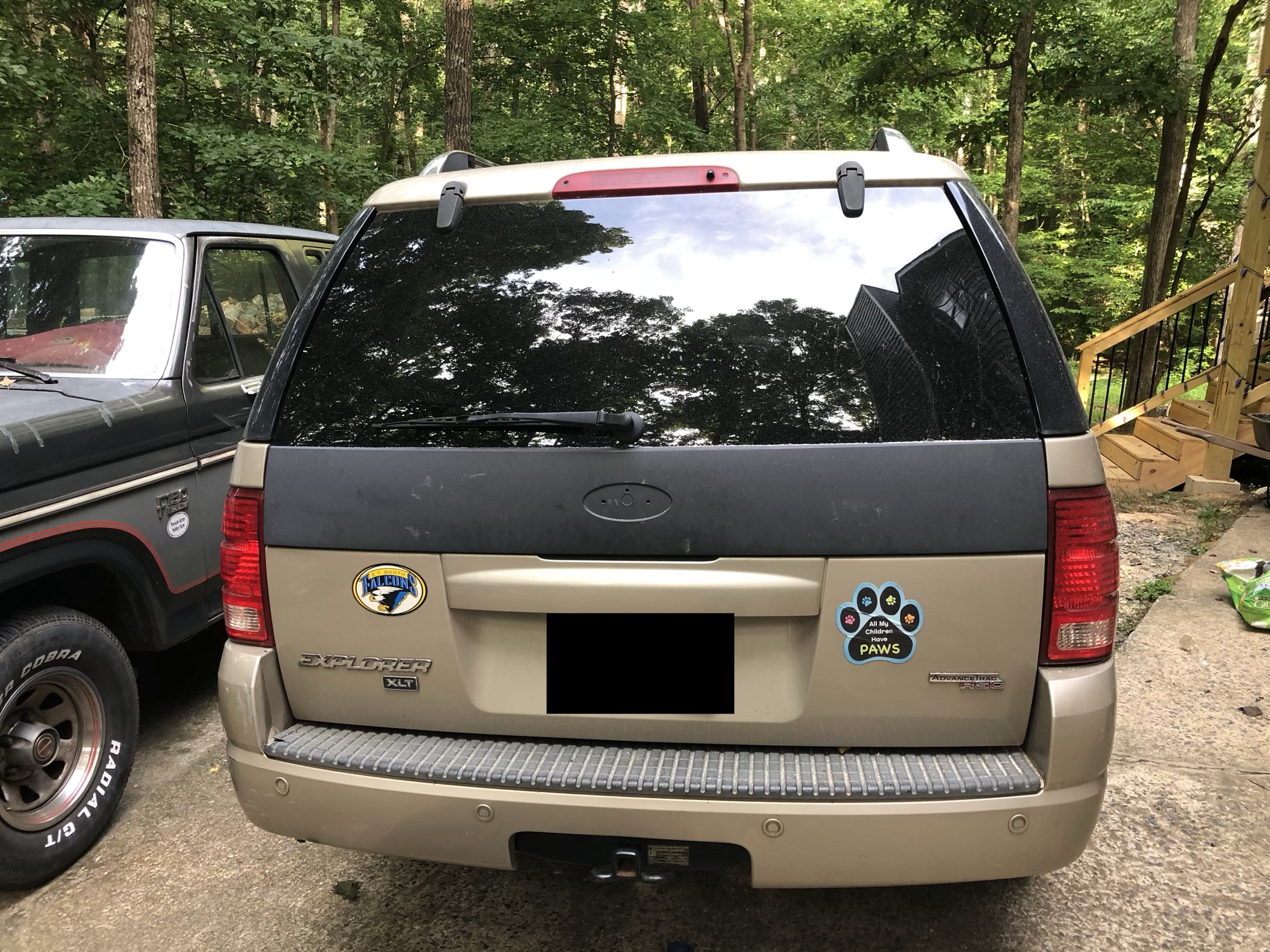

The paint and body shop wants $300 to paint the rear applique on my 05 Explorer.
Has anyone used spray paint to successfully paint this?
Primer, Paint, Clear?
I did it on my last '03. It came out just okay...it was passable; it wasn't perfect but it looked a lot better than the bare primer color it was before I painted it. The part was already in primer so I first wiped that down with some rubbing alcohol to clean it up a bit, then I just got a Duplicolor spray can of the body color from one of the chain parts stores and some clearcoat, sprayed a few thin coats of color first. Waited for that to dry a bit, did a light wet sand, and applied clear after that. I could've probably sanded that and buffed it too, but it looked "good enough" for me.
I painted it while it was on the car too. Just took contractor-size trash bags, split them open, and taped those to the areas I didn't want to get sprayed.
