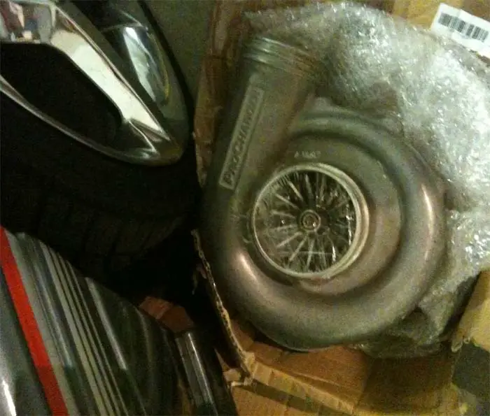

funny you mention that.... I have a procharger sitting in my garage for one of my other cars..
it's a GMH though..:D

loks like a VN SS commo there, is that wat the procharger is for?
Hey Morziac
Yep sorry about the late reply. Yep sure is a VN SS (had it about 8yrs) it was for it but now i'm seriously considering fitting it to the ex. Just worried about insurance.
