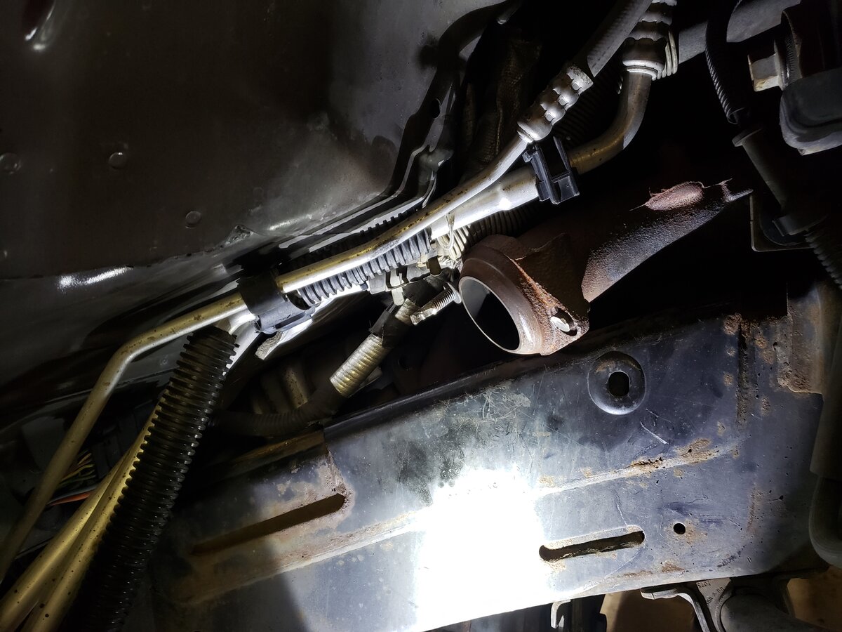

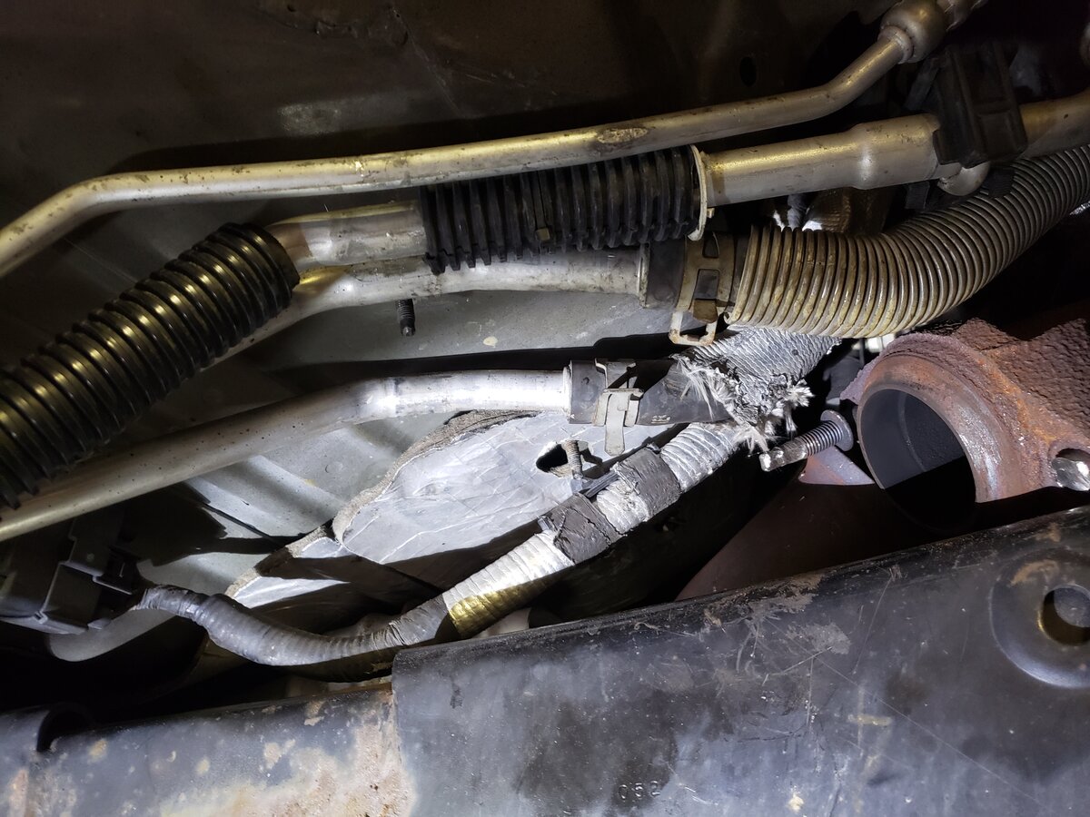

I need to replace the passenger side exhaust manifold on my 2006 V8 Limited. The manifold is loose, no broken studs but there are what appears to be rear AC lines in the way. I can't get the old manifold out. Is there a way to do that without opening the lines and moving them? I of course would prefer to avoid an AC recharge.
To update my own post, you need to take off the plastic clip that holds the ac lines to the inner fender. Totally remove that and you'll be able to move the ac lines around enough to get the manifold out.

I was fortunate that this job was done to the vehicle just before I bought it and all studs were stainless and they came out well. About 70000 miles later the passenger side was ticking so it was time. I didn't have to remove the starter. Its tight of course but it's all doable. Finished up this morning and she's nice and quiet again.
