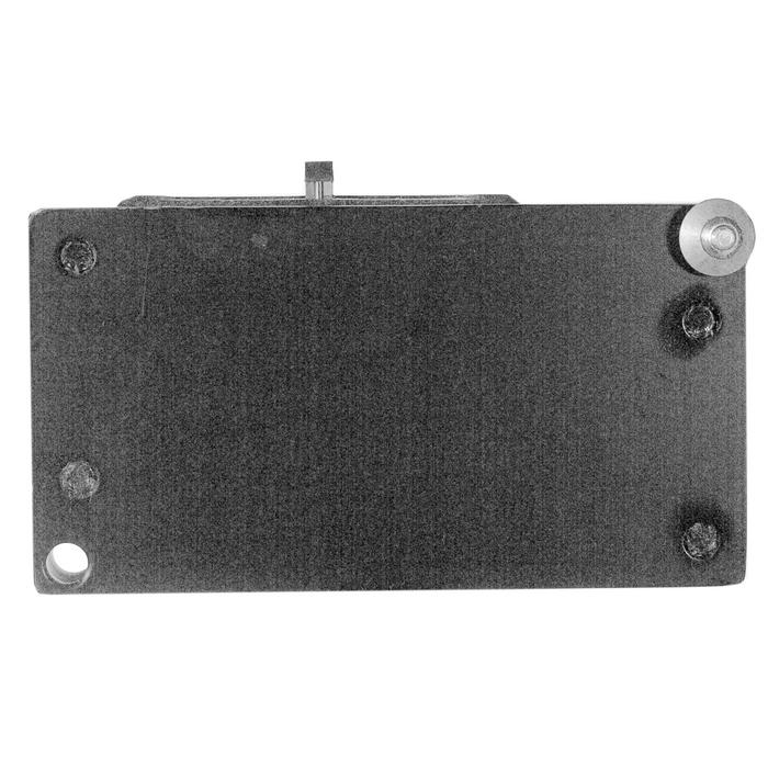

http://www.rockauto.com/catalog/raframecatalog.php?carcode=1105209&parttype=7172
1997 FORD AEROSTAR 4.0L 245cid V6 MFI: Ignition Control Module Price Total $173.79.
AIRTEX Part # 6H1107
Distributor-Less
The price is kind of high to take a gamble, so you might want to look around for a used one.
