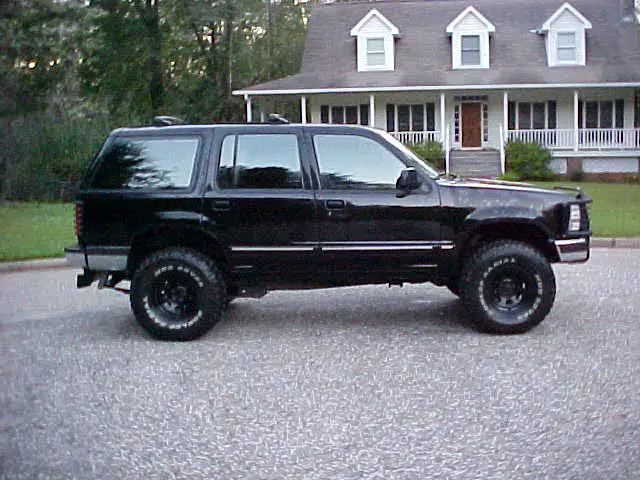

Thanks! I did zero trimming to fit the 33's, and they never rubbed except slightly when off road. Here's a side shot with the same setup.

Your truck makes me want to do the body lift....did you like the way it handled and looked from the side? Thanks for all you help....maybe on day I can go to a 6in lift!
Haha, believe me, it won't stop with a body lift. :D To be honest, I hated almost every aspect of the body lift. The frame hung down under the rocker panels and bumper and looked tacky, it added body sway, my hitch looked terrible with it, and the steering extension never worked right (probably just my truck though). Now, body lifts look better on some trucks than they do others. If I had a hidden style hitch, cleaned up some of the undercarriage, and fixed the steering extension, it wouldn't have been bad at all. Just make sure to take care of all the angles and it should come out great. Good luck with it.....
