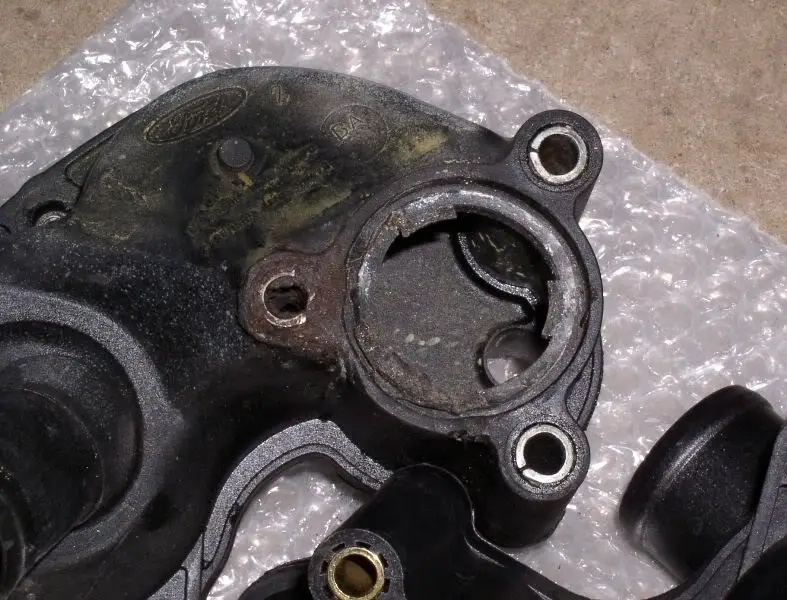

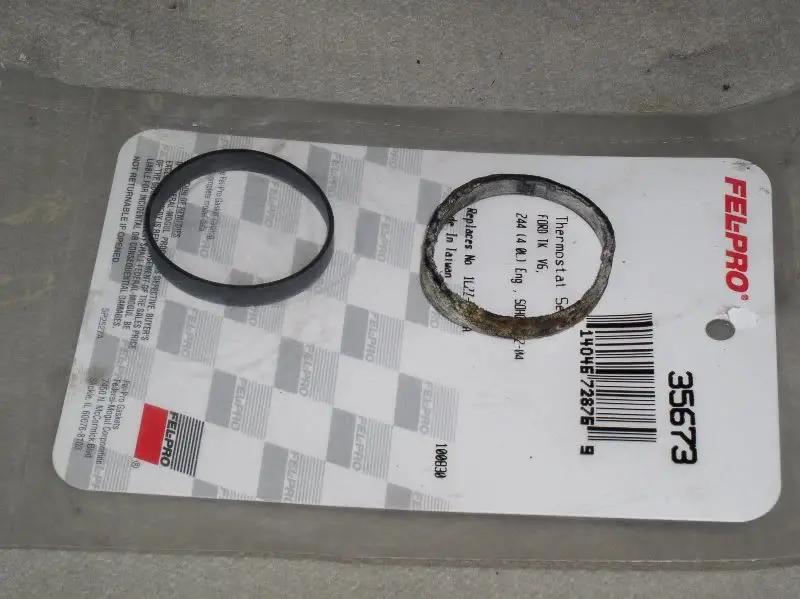

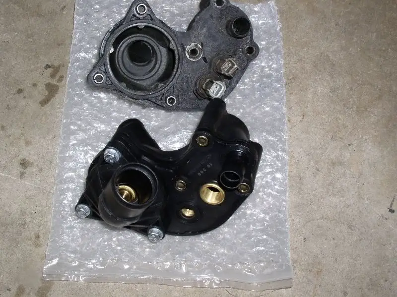

As most of you read in my venting post, replacing the thermostat assembly was not the delightfull and easy job we are hoping for. Dis-assembly was a motherF%$$#^ and the true culprit of all the problems was found, a $3.00 "O-ring".
I went on-line, and found at a few locations a replacement assembly, a DORMAN 902-204. I also ordered a new lower bypass hose, since I had cut up the old one, and while it was that far apart, best bet was to replace anyway. Advance Autoparts had one in the next morning, so I ordered there, $149.00.
I went to the store with the old parts to compare, and it was good I did. The party physically had the same body dimensions and mounting holes, but the part came without sensors, and the replacement part had different sized threaded holes, much different than the Ford part:
So, realizing I was between a rock and a hard place, I checked with the parts guy there to see if they had the two sensors in stock that fit the new housing. Thankfully, they had both! Parts are: Made by BWD, P/N's WT724 & WT5053. I added them to the growing parts pile, and hoped they would work.

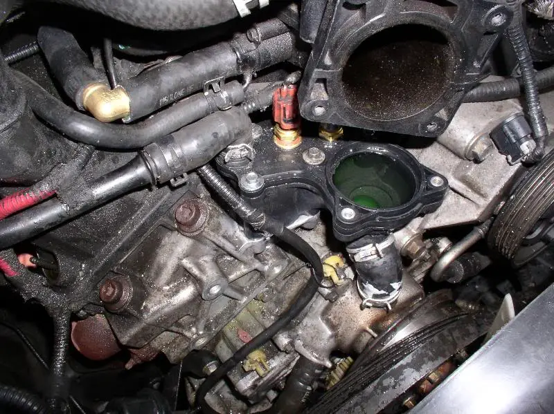

Installing the new housing was much easier with the alternator and bracket gone:

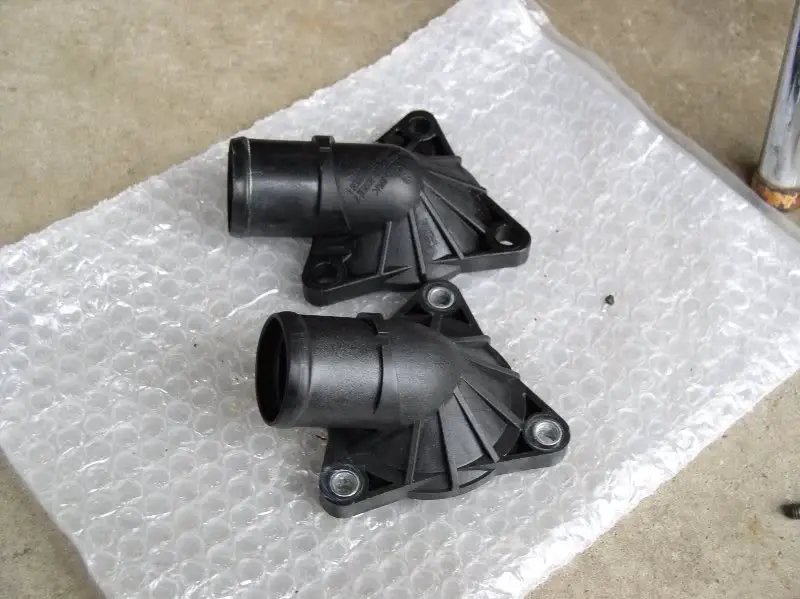

A second issue the immediately became apparent with the thermostat cover/outlet. The outlet had a higher angle than the original piece, and hit the throttle body mount on the intake manifiold. As well, the new one has metal inserts in its flanges, where the old one mounted over the extended metal inserts.

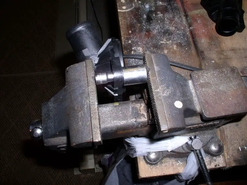

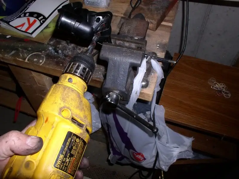

I opted to modify the original outlet, so using various sockets and a bench vice, pressed the inserts out of the new part
And then enlarged the holes in the original part and pressed in the inserts with the vice
From there, reassembly finished normally with no other hiccups. I forst filled the system with water, so when testing and if it failed, just water was wasted, not expensive anti-freeze. Got it running and let the truck run for a while, building heat, and checking the temp gauge, which read identical to how it did with the Ford sending unit.

And some final notes, here is the real problem encountered when dis-assembling:

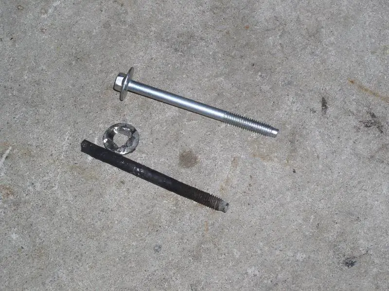

When the O-ring failed, it allowed coolant to get into the bolt area, and froze the bolt to the plastic housing, so it would not turn and ultimately rounded the head while trying every wrench I had. I ultimately used a Dremel and ground the head completely off and bent the housing and bolt towards the front to remove. A new bolt was purchased at Ford for $2.07 I also used anti-Sieze on all the bolts going into aluminum, so they also would not sieze.
You can also see my cheap repair for the collapsing vacuum hose that also commonly failes, a brass plumbing elbow that fits inside the vacuum hose. Simple, effective, and does not require any hose bending.

What a PITA to do all that modification to new parts! I'd say they ordered you the wrong housing, there are several.
Thanks for the photos and write-up !
NCR -
I could not find any other assembly listing, and this was available quickly, so I took it. If there is another Dorman Number, add it to this thread, and then maybe add it to the FAQ's or Tech articles?
Everything is working fine, so I am not complaining, and very happy to identify and show a common problem, and straight-forwards solution.
Dan
Does anyone know the route of that vacume house he has taped up? The one next to the --stat housing. mines all chewed up and looks like a pita to replace. thanks

Do you know the part number for that bolt? I got a new housing but yet to swap it out, tried it once but stopped cause 1 stubborn bolt wouldn't budge the very back one, so I would rather be prepared 2nd time around.
