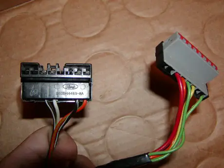

The Explorer itself has two radio harnesses coming out of the dash. They both have a connector on the end that looks like an L on its side....See the picture below.
One should be grey and black and has 8 wires coming out of it. This is for the speakers... Do you have two connectors that look like this coming out of the dash? You have to hook the 8 radio speaker wires up to the grey connector......

Wait those wiring harnesses that you are holding are totally different than the ones i have....wish i can take a picture...the one coming from the stock radio which is for the speakers is a small balck one and the one for teh power is black also.
ok i just went and looked at my stuff in the back and the two wires you are talking about one is round and has a metal pin at the end this is what should be plugged into the cd players power connection which youve done if it turns on. This is the part i believe you are missing there is another black wire with a metal box connector that has like 12-15 small holes this is where you need to plug in the wiring harness so you can hook up the speaker wires coming from doors to the speaker wires coming out of the back of your cd player. If this is already done than its the headunit it self and should be returned asap. The ones in the pics earlier are the factory harness for power antenna,12 volt constant,ignition,ground,dimmer,etc and the other one is for the speaker wire like he said. If they look differnent it may be because the previous owner had a wiring harness in there already at least mine did. If you really want us to help you you need to get a pic or sumthin cause its hard to explain to someone. Chances are its something little and is staring you in the face ;)
