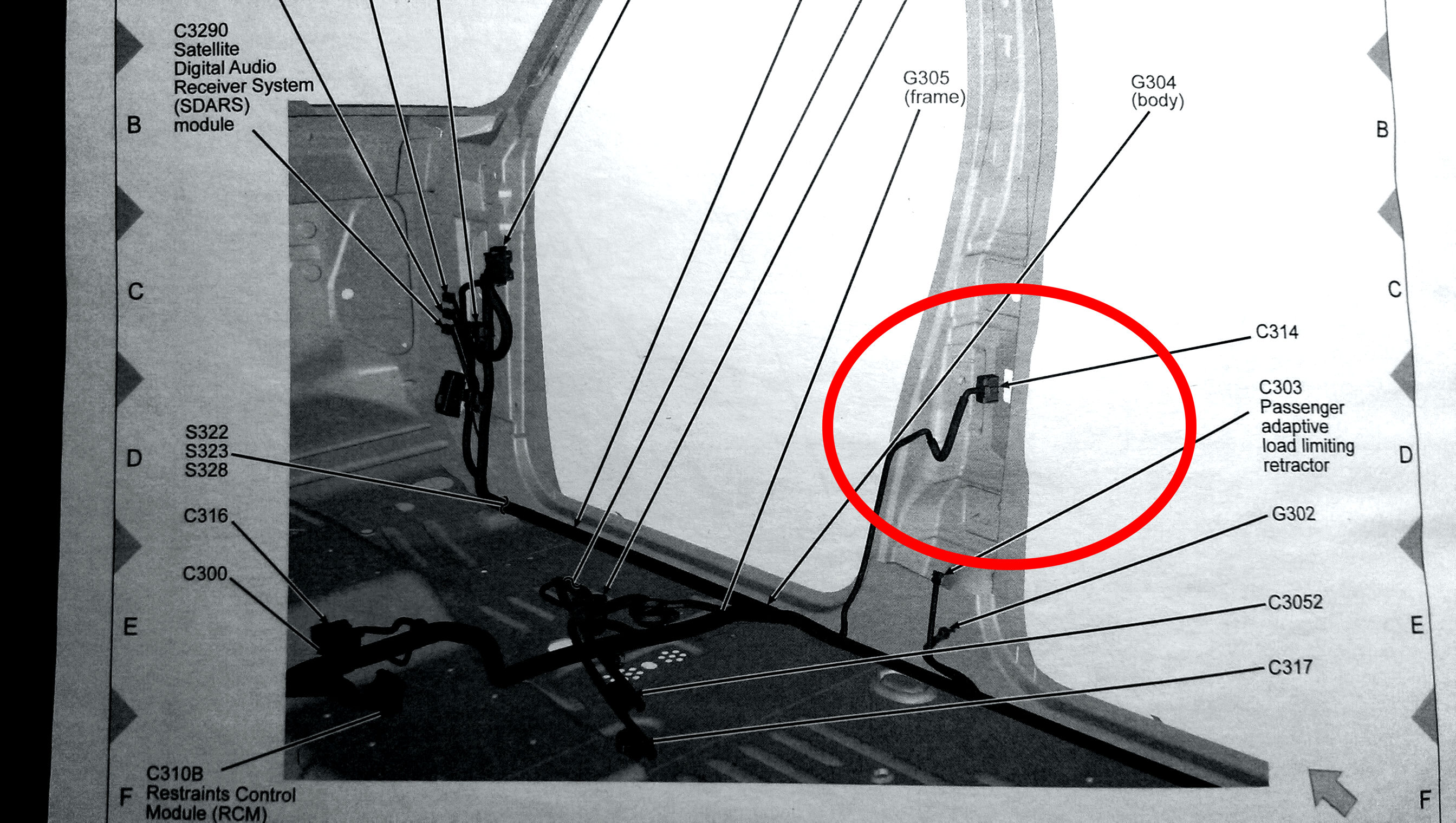

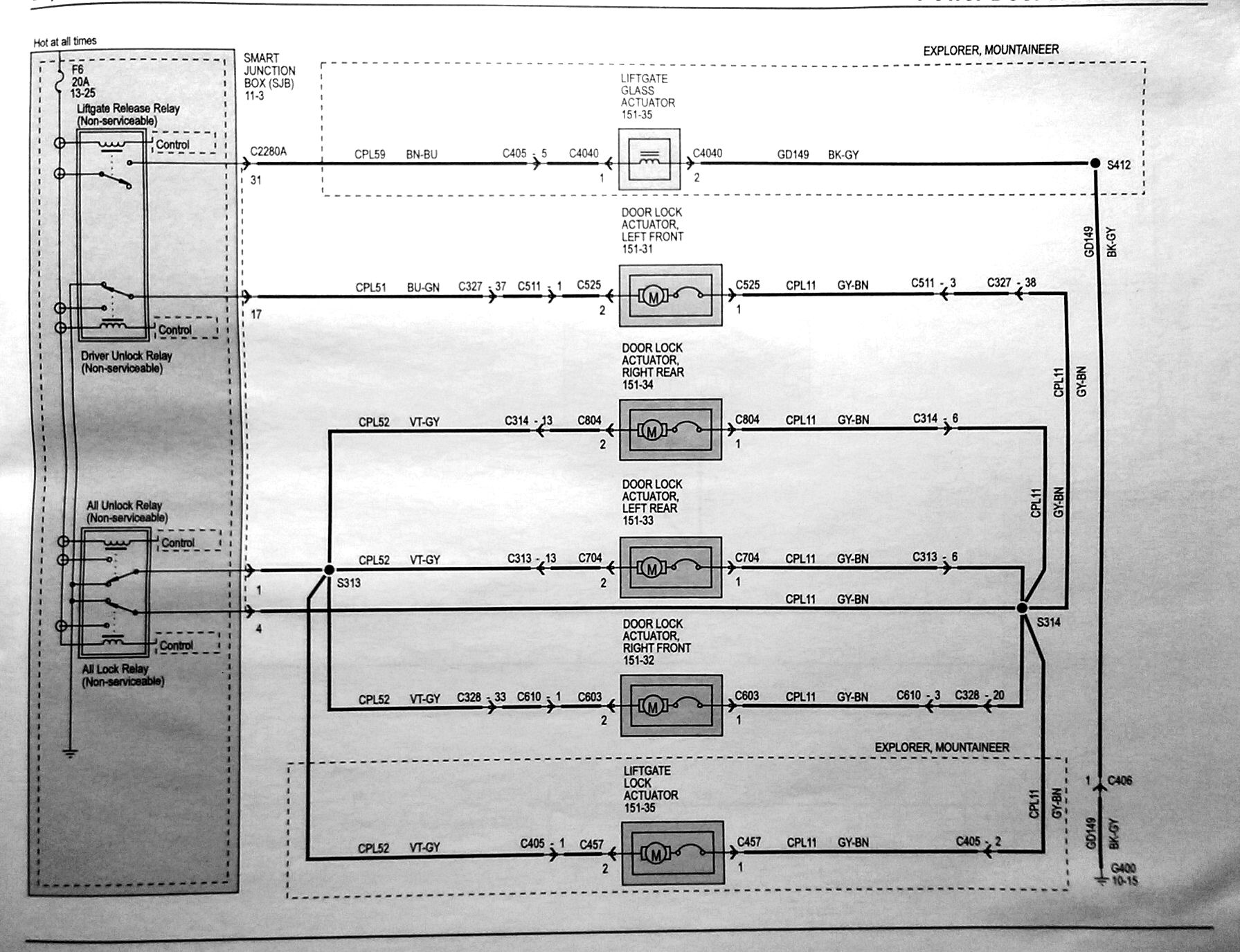

The wires you are looking for are found on the harness running along the passenger side B-Pillar, between the two doors. Colors are:
Violet-Gray
Gray-Brown
I have included wiring diagram pics for your convenience.

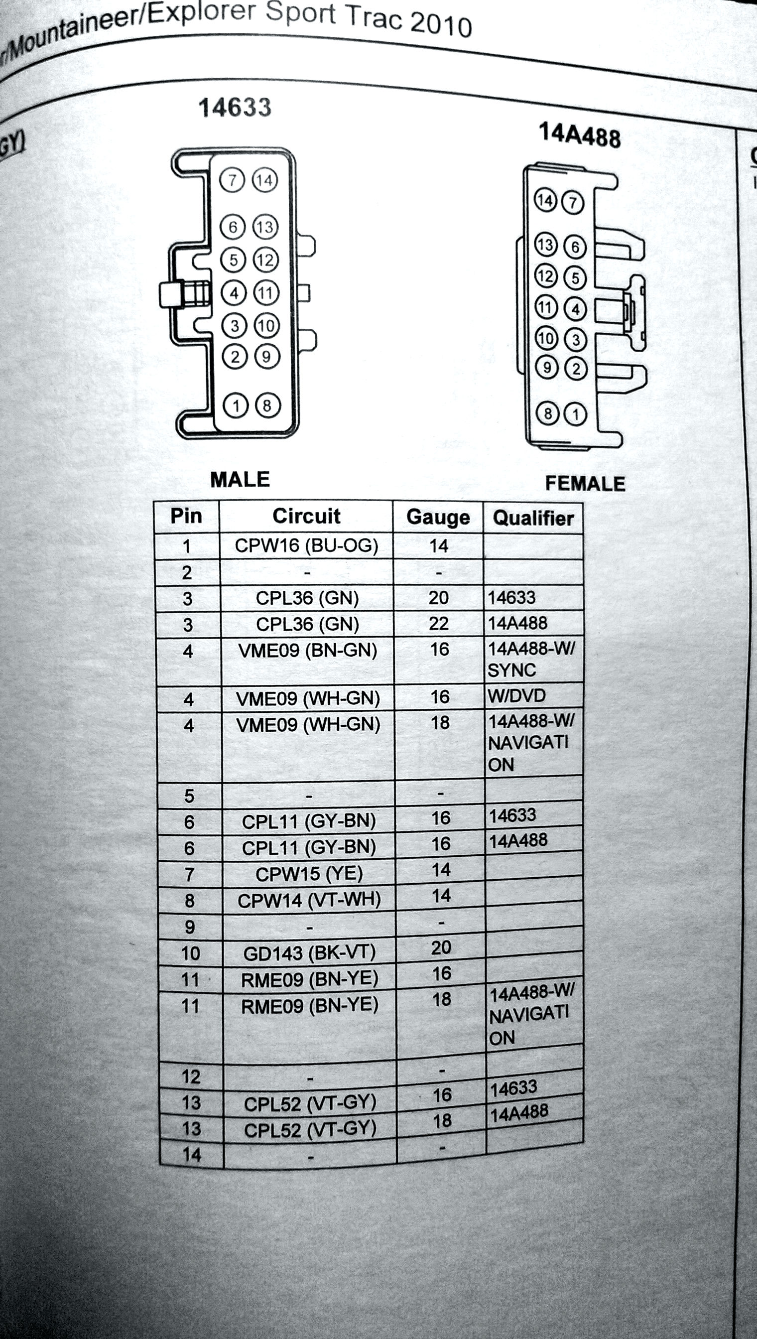

I do appreciate it. Only issue is a have 2 sets of wires with those colors. Any idea if they are the smaller or larger gauge wires of the pairs?
Fairly sure they are tied together at the connector, so use the larger 16 gauge. Make sure to check with multimeter and your remote keyfob to doublecheck the signal either way.
Copy that. I bought a computer safe circuit tester so should be easy enough now. Thanks again for the information.
