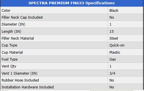

In order to be efficient and not have to get down up under the left rear twice, what is the size of the fill neck hose? I'm inclined to think that is what the problem is and not a rusted out filler neck tube(pipe). This truck hasn't seen any road salt and is not rusty.
Thanks in advance on the tube size and I'm going now to look on Rockauto to see if they might offer the rubber hose.
I looked to see if Rockauto offers hose and I haven't found it yet. However, I did find the hose sizes for the filler neck. Bellow is a snip it capture
of the filler neck specs that has to do with it. 1" id I suppose. It seems small doesn't it?,
There are two hoses. One for the filler, and one for the overflow.
