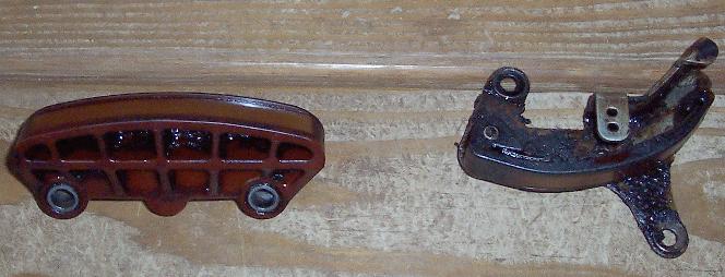

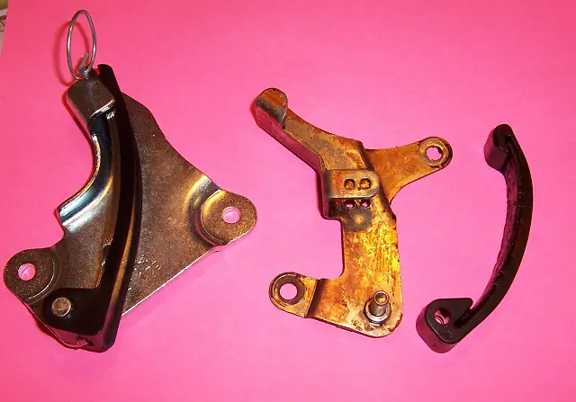

Your 2002 should have the improved tensioner with the wider base and six leaves shown on the left below.
However, even the improved one can fail after 200K miles. You might try listening with a mechanic's stethoscope or a length of flexible hose to see if you can locate the general area the rattle is coming from. Be careful of rotating engine parts.

Thanks for the great picture of the primary chain tensioner. Replacing that is my summer project. I searched through all of the tensioner posts and was wondering if there was one for replacing just this tensioner. Do you know of one? Thanks!

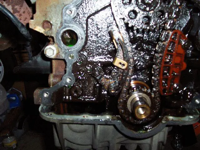

Probably the only simple and fairly reliable way to confirm the primary tensioner has failed is to remove the lower oil plan and check for broken spring leaf and plastic parts. In my case the tensioner failed (no pressure on the chain) but remained intact.
The sludge is a result of the previous owner installing a low temperature thermostat in a futile attempt to compensate for an inadequate (single row) radiator.
The primary tensioner can be replaced with the engine in the vehicle and retiming the camshafts is not necessary. However, the front timing cover must be removed which involves removing the serpentine belt, viscous cooling fan, the harmonic balancer, alternator and support bracket, setting aside the A/C compressor and power steering pump and support bracket. I can't remember if removing the radiator is required but doing so gives easier access. It could be done in a day but you should have back up transportation available in case problems are encountered. Some members have difficulty removing the harmonic balancer.

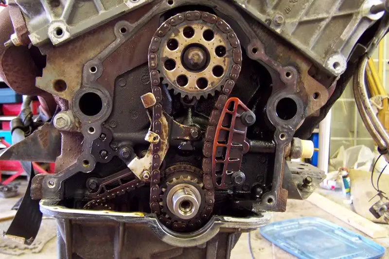

Once the timing cover is removed it takes less than five minutes to replace the primary chain guide:
Remove two bolts
Pop out the old guide
Push in the new guide
Screw in and torque two bolts
My guide with 150K miles was barely worn. I only replaced it because it took so little time and I already had the part which was fairly inexpensive.
Since I have been a member of this forum I can't recall any member whose engine was damaged due to a failed primary chain tensioner except if the broken pieces blocked an oil passage. I doubt there is enough slack in the chain for it to slip even if no tensioner is installed. The chain is very strong and destroys the tensioner before there is significant damage to the chain. I encourage you to determine if the tensioner has actually failed before spending the money to have it replaced by a shop. Just pull the lower oil pan and inspect for parts. If you find any parts remove them and clean the ones in the oil pickup screen and reinstall the pan. I reused my OEM pan gasket and it doesn't leak. This could easily be done on your Sunday off. Post a photo of the parts and we might be able to determine where they came from (primary chain tensioner, balance shaft chain tensioner, left or right cassette guide assembly).
