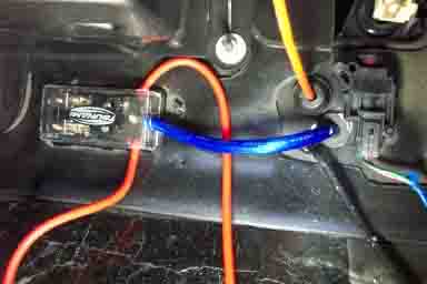

I just drilled my own hole behind the passener wheel well.
The photo is of the inside at the distro-block.
Sprayed some good primer on the hole, popped in a rubber grommet, sloped it all up with sealant and there you have it.
The blue wire is from the battery and the two orange / red ones go to the amps.
