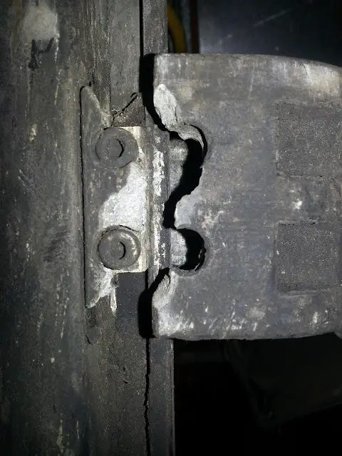

Following up: I finally got the Mountaineer to the shop, our mechanic took the running board assembly off, and here is what we found:
It's the mounting bracket that's broken. Carp.
The bracket doesn't seem to be available by itself. I doubt it can be welded?
