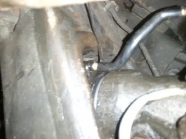

I just became a new member to this website and i need some help.i have a power steering leak coming from a hose that is supposed to be connected to the pass side boot. i cant seem to get the hose back in the boot all the way. Is there something that im doing wrong or is there a certain way to get it to go in? if some body can help it will be great.I have a 98 ford explorer sport
Can you take a pic? Cauz the only boots that I can think of are at the end of the rack and they dont really have anything to do with the hoses.
heres a couple pics i could get of it
if you have fluid in that black hose, one of the rack's seals is leaking.
