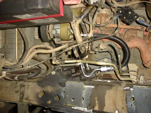

Could any of you guys ussing the early explorer or ranger box post a pic of how/where you mounted it to the frame? I am looking at the way the frame is on my 99 compared to the earlier ones and im not sure how it should mount.
Heres the bronco box on mine on the outside of frame. I think most other people are putting them inside the frame rails which is impossible with the SOHC. Radiator and other stuff is in the way.

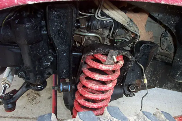

I have the exact same setup as Robb, since the same guy did our trucks. I've had problems out of mine. I keep breaking the weld around the tubing going through the frame, so i took my box off and welded a plate on the outside of the frame for the bolts to go through. I haven't done the back side yet cause i had to leave for Iraq, but i do plan on doing that but i'm not sure how since is has that indent toward the rear. There are no washers there. The tubing was cut to length to square off the box before it was welded in there. The tubing touches the box in both locations.

You NEED to weld tube inserts all the way through the frame or the frame won't be able to hold up to the abuse. Welding a plate along side at least one side of the frame isn't a bad idea either.
Pics from my truck:
Under construction:
Broken on trail:
Problem fixed:
I kept busting the welds on the outside of the frame on the tubing, that's when i welded the plate on the outside. If i were to do a new SAS job that requried that type of setup, i'd weld a plate on first, do it right.
I also did the same thing Jefe did, busted 2 grade 8 bolts.
