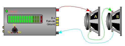

According to the Kenwood Owners Manual for this head unit the minumum OHM load for the speakers is supposed to be 4. So, running these in a 2-Ohm load may be causing problems. Are both of them making the noise? Or just one? From your original description, it sounds just like one. As a test, you can wire them in a 4-Ohm load, but that might take some finagling. It would also limit your ability to balance the speakers between left and right.
But, if that isn't a huge problem, you can use this wiring digram and basically hook them both up to the same front channel. It will allow you to produce a 4-Ohm load for the speakers. In order to get the full power from the head unit, you can just run two sets of speaker wire from them to the left and right front channels.
I know it is setup for subwoofers, but the same information applies for regualr speakers. Most diagrams are setup for subwoofers though and it was just easier to find.
