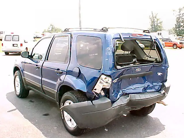

The upper left small photo is what you should see when looking at the flange coming out of the transfer case after removing the driveshaft. You should be able to see that big nut, as shown. The driveshaft is supposed to have the silver cap on the end to prevent the CV joint from coming apart and the balls falling out. That cap is sort of pressed in IIRC. The one in my photo that is apart failed because the Escape was hit in the back, not from wear. I bought it wrecked and fixed it. Like you say, that is what I found when the 4x4 didn't work. Also had a heck of a clunk!!

On the Escape I fixed the shaft was driven into the t-case and the cap was literally molded to the flange. You HAVE to have the bearings in place and the cap on it to install it and it stay in place.
