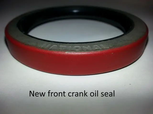

Specifically, the front oil seal located on the timing chain cover.
Below, I see there's a special tool for installation of the front oil seal. Is there another way to do this, a different tool, or one you can rent at a local auto parts store?
Cut a piece of PVC pipe with diameter close to the outside diameter of the seal, then with a large washer and the crank bolt just ease it in?
Other question is why do the instructions above appear to instruct to put motor oil on the front cover and the inner lip of the new seal to be installed....then there's a note to say that the seal needs to be secured within 4 minutes or else you have to start over again and remove the "sealant"...did they mean to say that the cover needs RTV instead of motor oil? What "sealant" are they talking about?
It appears that the new seal, manufactured by National, comes with a red sealant already applied. They call it "RediCoat". According to their statement:
"National from Federal-Mogul has been a trusted brand of replacement parts for more than 60 years. Our seals feature our proprietary RediCoat sealant, designed to provide a proper seal in spite of minor bore imperfections."
Base on this it appears I do not need to add any kind of RTV sealant. Further, I would think that if RTV was used then if at future time you needed to remove the front oil seal you'd have one hell of a time getting it out plus you'd have a real difficult time removing the old RTV when you prepare the cover for a new seal.
I believe that I used a piece of schedule 40 and just tapped it in with a small hammer. I did this on the bench with support blocking underneath.
The lip of the seal, only, should by coated lightly with lubricant, grease preferably, Vaseline is good, carefully to not get any on the seal's outside diameter, as that interferes with the pre-applied "sealant" from achieving a leak-free OD condition. Of coursed, the seal bore in the cover must be free of oil completely and dry. RTV would make little or no difference in getting the seal out someday, as the OD is a press-fit of 0.005-0.010 inches. imp

I agree 100%. I had a hell of a time trying to get a new seal in. I used a harmonic balancer installation tool, plus a large washer plus a PVC coupler that was near a perfect fit to push the new seal in. Even with everything lined up perfectly with the install tool the fit is sooo tight that the seal did not want to go in straight. I ground down another PCV coupler so that I had a "C" shape up against the seal to push on the side that was sticking out a little bit more. I got the seal in but the couple of places I pushed on with the "C" shape slightly dented the outter seal ring where pressure was applied.. We'll see if it's good to go or if I'm going to have to tear out everything again and try again with a new seal. I get the impression that the seal is supposed to be a "register fit" but IMHO it's more like a press fit which isn't a good idea since the seal is thin metal. It's just really too tight for tolerances with thin metal.
@SyberTiger
It is much better to press a seal in, if possible. On smaller covers, a large vise will work, axle press best. Hammering 'em in seems to always "****" the seal. 'Course, with an extension housing under the truck........imp
