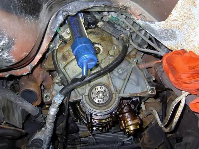

My first Idea is the aftermarket cap for the rear jackshaft access has gapped open inside the bellhousing. Not sure, but I'm not pulling that engine again. I'm thinking I can pull the tranny and inspect/ replace. Ideas?
QUESTION: with the transmission out, are you able to replace the 2" round jackshaft cap?

At least one forum member has replaced the rear cassette by pulling the transmission instead of the engine. Before doing that I suggest that you make sure the hydraulic tensioner is not leaking. Did you install a new O ring? The O ring can easily slip down during the installation and leak. Some members use a thick grease to hold it in place.
Here's what you can expect to see after pulling the transmission:
There's no need to remove the oil pan or reinforcement section as shown in the photo.
Also, make sure the leak is engine oil and not ATF.

the picture is EXACTLY what I needed to see. the front tensioner is good advice. I've got some uv dye and will do it this week. The front tensioner would be an absolute blessing if it was the front. (hey, plenum off, tensioner loose, rtv, plenum on and roll) Somehow I'm not thinking I'm that lucky.
