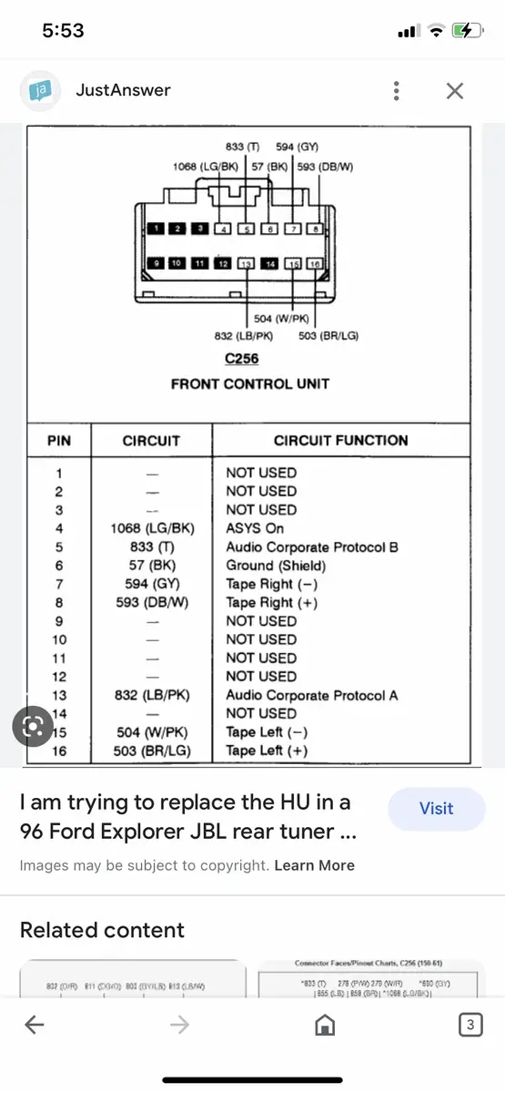

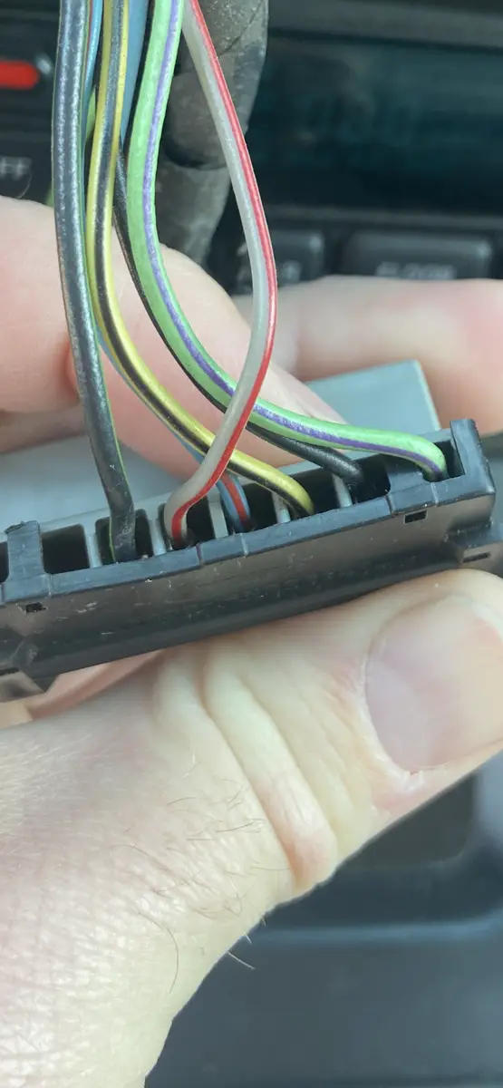

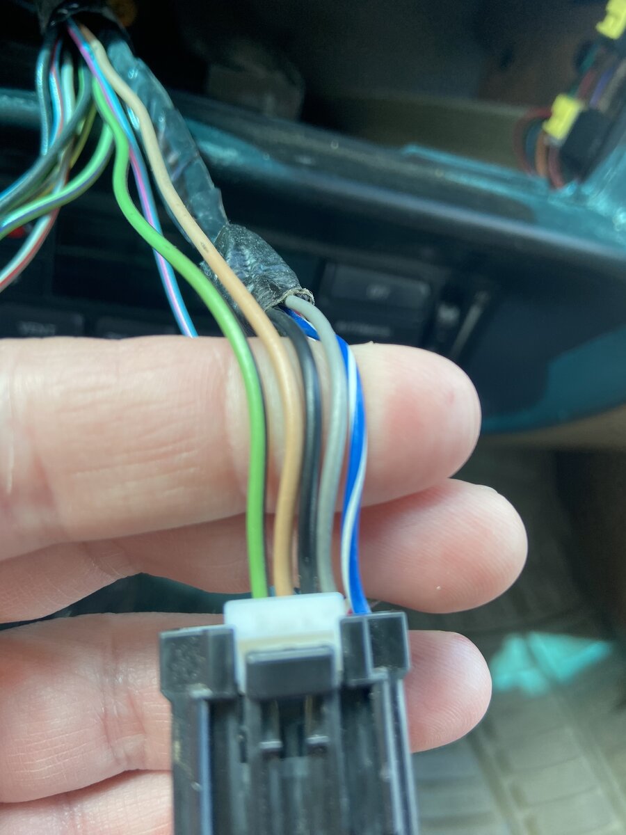

I can’t find anywhere the diagram for my one radio plug 1996 explorer limited 5.0 awd jbl tape with cd in glove box and rear sub I found the one for the second plug. But none of the other diagram s I found on the site have the other plug and correct colour of wires ??? Any idea ?

Get the wiring diagrams for 2nd gen linked in my sig below. There are a few different radio options and you can compare to yours.

OK Thank You very much. You have tones of great information in there.
