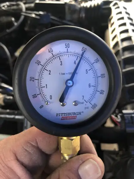

Have already changed gaskets and have sprayed countless cans of cleaner around gasket and vacuum lines no leak today the ecu told me it read a c1 misfire then cleared up then it bogged out again and gave me a c4 misfire then cleared up but it bogged out really bad I did fine out the pump don’t turn on when I turn the key till like the second time I turn it and the pump it self don’t hold no pressure but don’t really know if it’s suppose to hold pressure or not I got 20-28psi after the damper on check valve on fuel rial

The pump is supposed to hold pressure. The moment you turn the key one notch from the start (starter engage) position it (fuel pump) should run, bring your fuel line up to pressure, then if you do not crank the engine it should maintain that pressure until/unless you let some pressure out testing it with a gauge, and take a long time for the pressure to drop much.
If you have a returnless fuel system (pressure regulator in tank, fuel damper on fuel rail) it should be much higher than 20-28PSI, around 65 PSI. I am assuming all year 2000 (including the OHV) had a returnless system and if I'm wrong hopefully some one will correct me. You can see this for yourself by whether there is a second fuel line going back to the tank.
You might pull the vac line off the fuel damper after trying to run it, to make sure it is not sucking fuel through it. If it is not then the damper is probably fine and I'd look at the age of the fuel pump, sending unit, fuel filter, deciding what might need replaced. If it is losing pressure it won't be only the fuel filter, that could reduce steady pressure but shouldn't cause it to drop right away.
As noted above your fuel pressure is too low. Would explain the lean running condition and the hard starting.

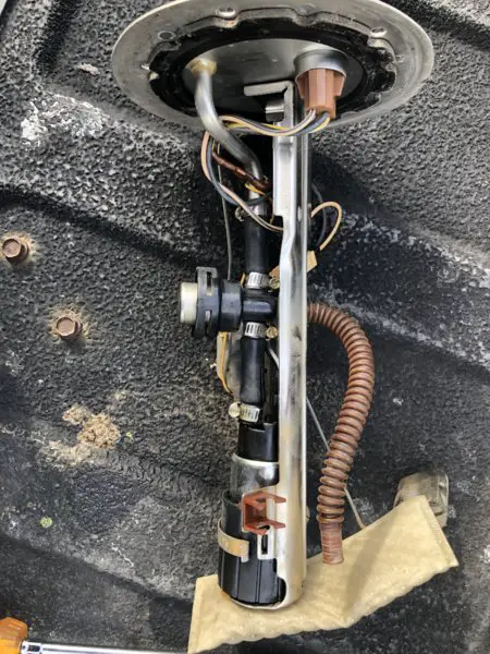

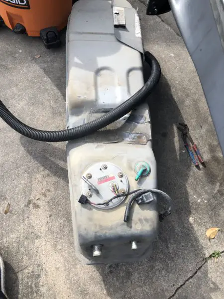

Thanks it’s a sohv I bought the sending unit already just didn’t want to install until I was sure I just drove it back to Houston from McAllen 360 miles all on one tank and no problems but did not turn off at all seems like when it starts off good it stays that way but I have an empty tank now so gonna install the pump and see how that goes still think it’s pretty good for one tank 360 miles 98% of them we’re going 75mph but will install pump and see how that goes and will touch back and no fuel return hose
Thanks again

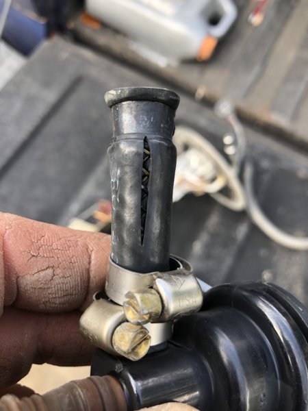

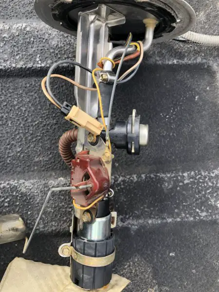

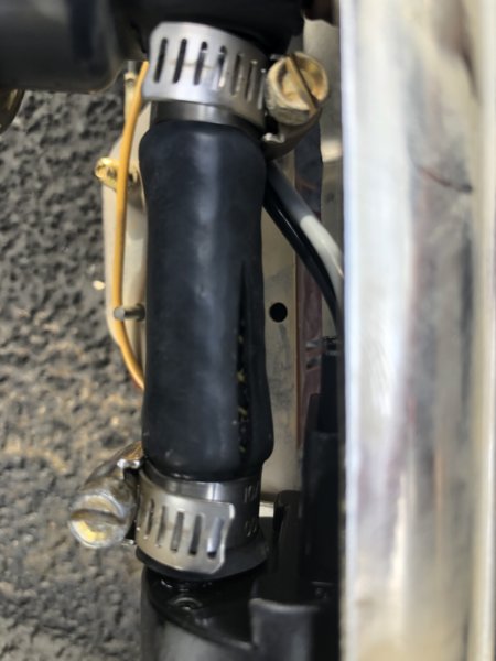

Ok I have removed the tank found a split hose between pump and what looks like a regulator guess now I know why I have low pressure
such a weird hose to split. if you ever have to replace the fuel filler neck hose make sure to buy it at autozone, the spectra replacement hose is known to split like that and autozone is the only store i could find that sells it with a lifetime warranty.
I'm surprised it managed to push 20+ PSI still.

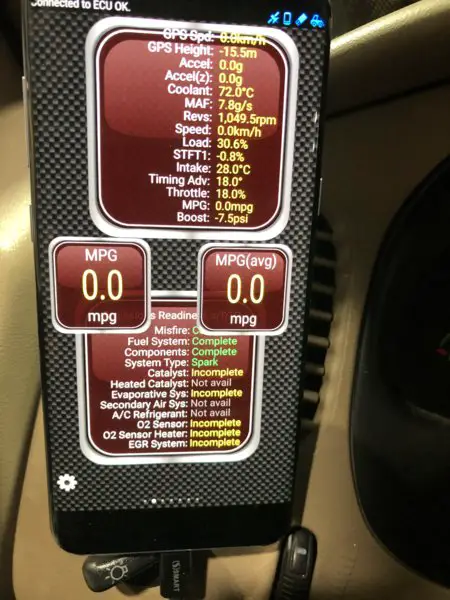

Didn’t use new pump after all just bought 1’ of hose and new clamps about $4 and now it’s working really nice now I get about 60psi and hello power lol gonna drive a while and see what happens now it’s starts right up

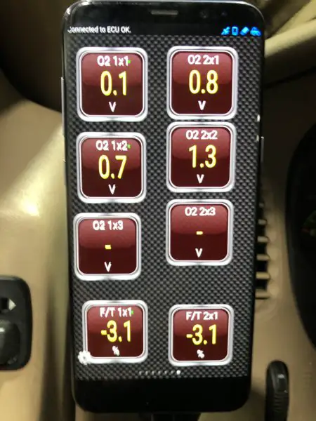

Fuel trims look a lot better and as of that other o2 sensor it’s marking I have no idea why this truck only has 3 and going to see if I can’t get all emissions to turn green once and for all
