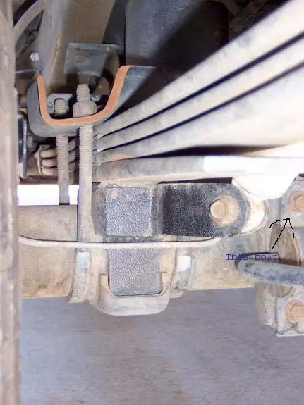

no no no no. Hang on here for a second. You dont need to change anything for shock mounts. Infact you have a set you just dont realize it yet. Take a look at the sway bar brackets on the axle. now just use the top bolt on each side for the shocks. DONE and FREE

There ya go. I dont have any pics of mine as its not the same axle anymore

Ok... shock question, I have rancho shocks that are the exact same length and width of the origonal shocks except one thing... the top part of the shock..
Top and bottom images (borrowed poloroid.. its horrable!)
Im not exactly sure what to do here, unless I have to buy new shocks (and sell the rancho ones)
There are a few possible solutions. One would be finding that cross piece and putting it in your rancho.s rancho calls that crosspiece "XP7" Or you could try to reuse the stock ones by cutting the studs off or driving them out, then drilling out the holes, then press them into the rancho eye. I would probably just go get the correct ones if you can.
Had to use the old crosspins for the top mount (was a pain to get out but they work fine).
Problem im running into now is which hole to use of the old sway bar bracket. The top one gives me 3inches of upward travel on the shocks (top mount to where the bar goes into the shock itself, rancho 5000 shocks). The bottom mount gives me 7 1/2 inches..... but is harder to get the shocks secure due to the angle (top is hard too but i can get a socket on the back bolt, upward angle). Should I mount them to the bottom hole anyway?
sounds like they arent propper length. you will have to figure something out. remember drop is better than stuff
Yea I mounted them on the bottom hole, its close to 6 inches up (about the length of the bumpstop to springs). I think I will do fine for now. Working on rims right now... got a van in my way for my last rim... :D
