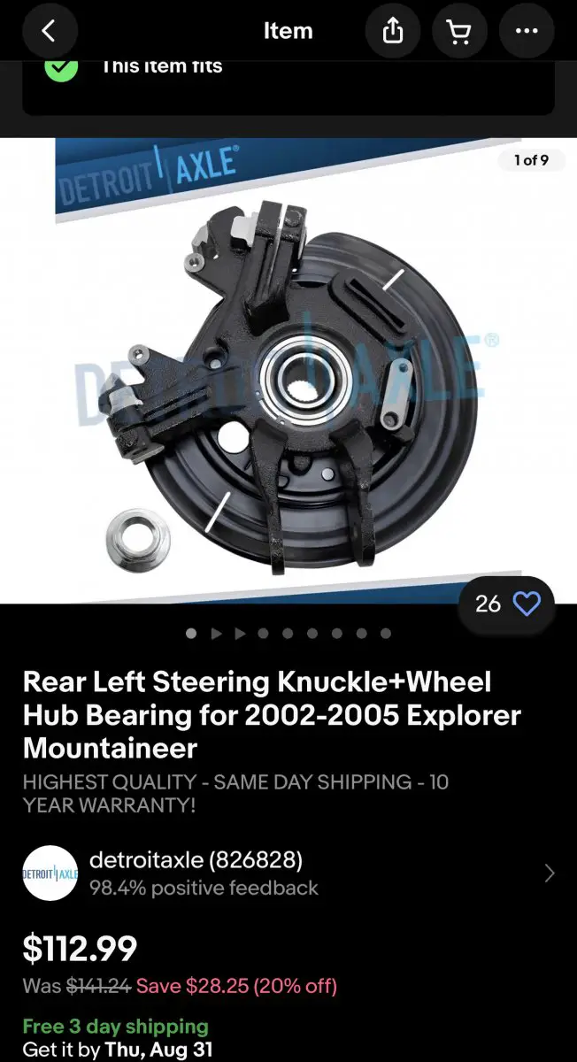

Does anyone have experience with this brand?
My vehicle is approaching 300k miles and I’m not interested in putting premium products on it. However, I don’t want something’s that’s just going to fail in 6 months.
Is there a brand you’ve used that has lasted?
