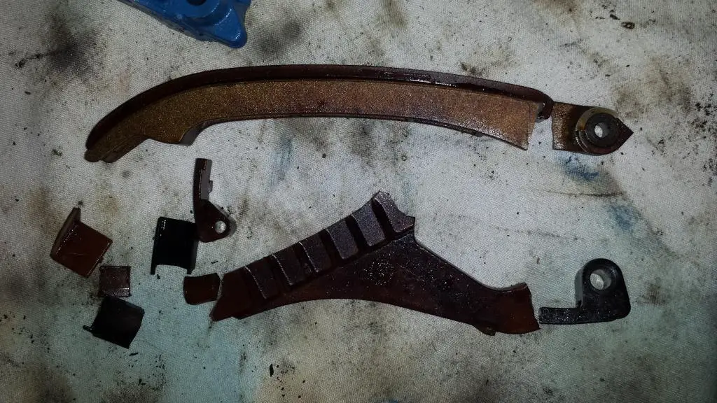

Here is a picture of one of the timing chain cassette tensioners from a 4.0 I took apart today that just needed a valve cover gasket. This engine ran good and had just a very small tick when started.
I would take an hour of time and take the valve covers off so you can look down the timing chain holes and inspect the parts as best as you can. While you have the covers off you will also be able to look and see of there is the rare possibility that their is a lifter or arm that has a pin coming out. I would NOT just start buying parts and trying to replace things until you find the culprit. I feel like the bearer of bad news and such a "joy killer" but I have yet to tear apart one of these 4.0 SOHC's with over 50,000K on it and find all the timing tensioners in tact. The good thing is that they will run and run and run until they damn near fall apart by themselves with bad chains... LOL:salute:
