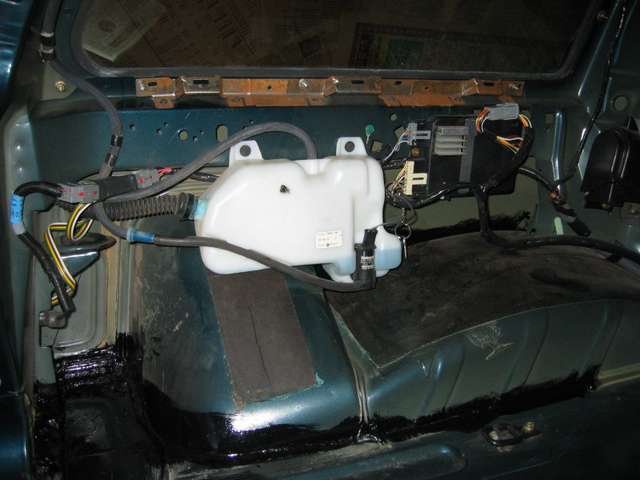

Was told when I bought the X used, that it had the remote module. It is a 93 xlt. I looked inside the left rear quarter panel. There is a black box in there. It had 2 plugs on one side and one plug on the other side. On the bottom, there is a little white button, that when pressed, a small red light will light up, if the ign switch is in the run position. Is this it? I have been looking for a jumper so I can program a new FOB. Any ideas?
You'll have one hell of a time programming a new FOB to a 4x4 computer.
That's actually the 4x4 computer.
Thanks for the info. Next question is, what is the white button and red light for?
That's the self-destruct button. I'd leave now.
Thats the self test button, but it wont do anything now.
Yes as the others have already mentioned you have discovered the 4x4 module. This module receives input from the 4x4 buttons on the dash and will send power/signals to the electronic shift motor on the T-Case to toggle between 2H, 4H, and 4L
