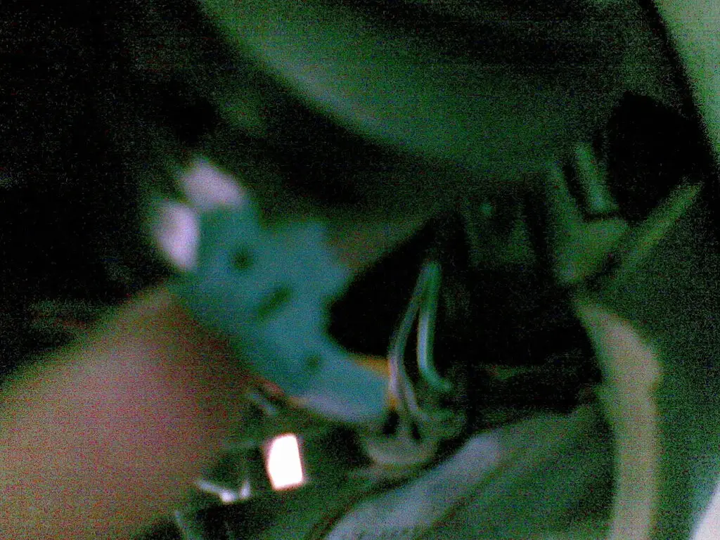

Sorry for the crappy pic, but all I had at the time was my cell, look for this thing, if it's loose then that might be the issue:
