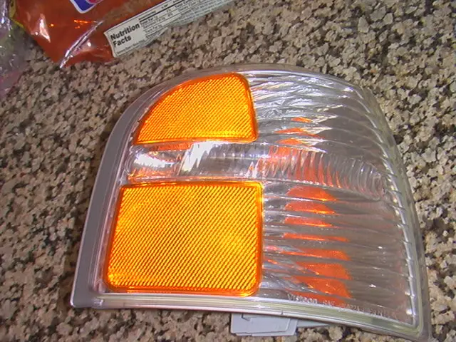

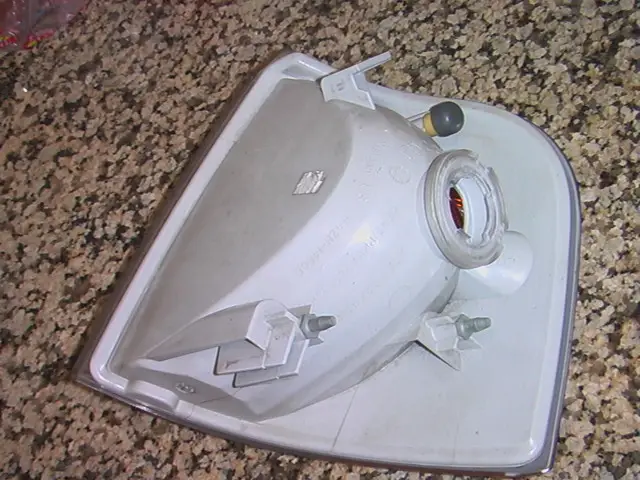

Whacked a deer in the head a few weeks ago, the only broken part was the driver's side cornering lamp. I pulled the old one out (easy enough, just one screw) but it looks like the bulb receptacle is one part with the lens assembly. Is this true or am I missing something? I found a replacement assembly online but they say "Doesn't come with bulb". I'm not sure if they say that because it's all one assembly, I can't see how it would be changed.
Thanks, Rob
This is the OEM passenger side lamp 03 XLT
The driver's side is identical... All I did was get this one out, and put the new one in.
Thanks, that's the picture I needed to see. On my original light it doesn't seem like the socket comes out of the lamp like yours, perhaps I need to turn it more.
Thanks for the help.
Rob
No problem... I think they are all the same. Good luck! :)
Got it, it was much tighter than I thought but it came out.
Rob
