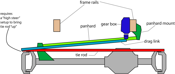

In reality, it is almost impossible to achieve a horizontal panhard bar and steering link because of the oil pan, frame rails and such, so you just try to get as close to horizontal as much as possible. So in the image below, I angled the panhard and drag link a little bit just to put it in perspective with reality.
But now that I think about it, I'm not even sure there are hi-steer knuckles and arms for Dana 30s, but search around. I know there are ones for Dana 44s so maybe you can just keep this in mind for the future if you switch over to a 44.
