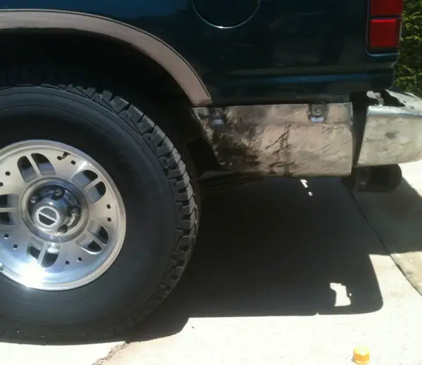

At my disposal I have a Dremel, a hacksaw, a jigsaw and a circular saw. I don't have much experience slicing up body pieces, and I'm sure most of those options will work alright; I'm just throwing this out there to see if anyone knows an easy tip or two, like "do the circular saw, it'll cut through like butter" or "stay away from power saws, they'll chew it up, do it by hand". I'm planning on painting next week (rustoleum and rollers, thinking of writing it up), so no better time for cutting/filing/sanding than now. Thanks!

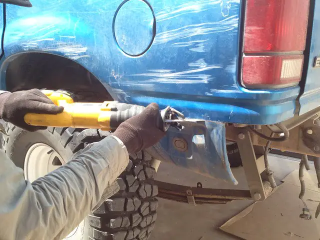

We didn't do anything special when we cut that off on our X.
I just used a cordless sawzall and a 2nd pair of hands to keep the metal from flapping when we got near the end of the cut.
removing extra metal -2 by maniak_az, on Flickr
~Mark
Your jig saw with a metal cutting blade will be your best option. I have a Dewalt grinder with cutting wheels that I use to cut sheet metal, but of what you listed that will work best.

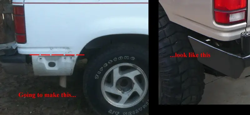

I Do Believe there is a brace behind the middle of that panel Above that rubber boot . I was Going to cut mine the same But thought about Re using My Stock flares for On Road Use .

The fender got pushed and bent upwards in half due to an accident, plus I like the look without it, but cutting into it proved to be too much for old Mr. Craftsman Jigsaw :(
Broke some teeth off and it headed to the big toolbox in the sky. Maybe it's time to go Sawzall shopping... :sawzall:
