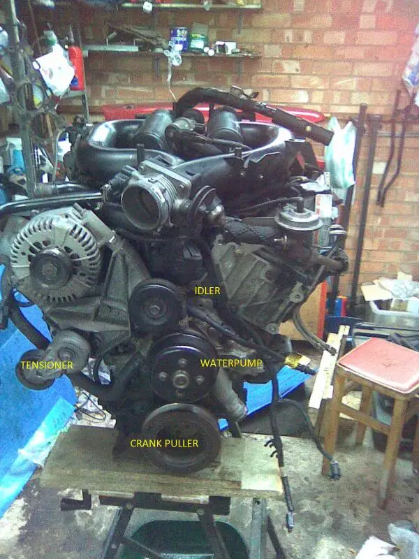

See the photo below. On the right you can see some bolt holes on the head, that is where the bracket for the aircon mount to. So if this is the area that is bypassed then its def aircon
It may be a case that whomever did the work on the engine doesn't deal with aircon and disconnected it to remove the engine and let all the gas out. And didn't refill but just used a shorter belt to bypass. It is all guess work and the seller should have the full story if you can believe him/her.
That's the area alright. It's definitely the air con compressor then.
