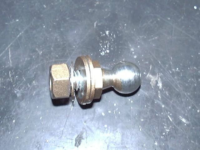

Ball stud

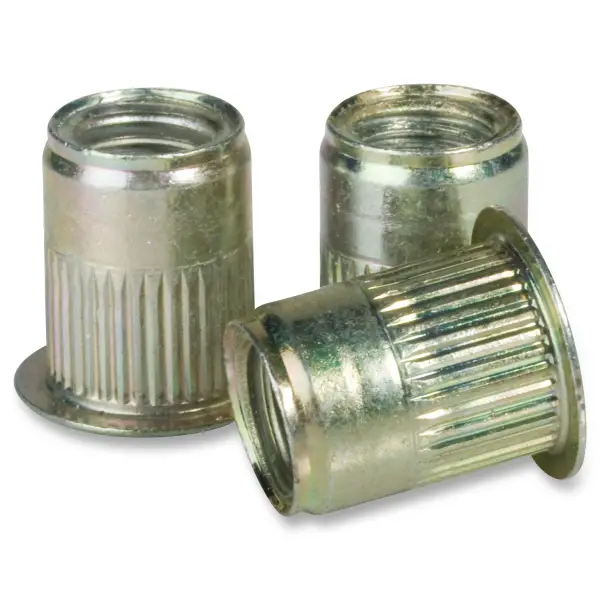

And a nutsert: installs like a rivet.

If it's JUST the ball stud itself that has snapped off, and the rest of the bracket (including the tab the ball stud was in) is still intact, you can just drill out the tab, screw in the replacement ball mount (pictured above), and use a nylon retainer nut (or metal locknut) on the other side. It'll probably be better than the stock ball mount.

Should be the right size, at least it was last I checked. The struts for the rear glass and the liftgate use very common ball stud sizes.
If there isn't enough space behind the tab to fit a nut, including a thinner nut or by banging back the sheet metal, then just drill the tab and tap it for the size of the threads that are on the ball stud, then thread the ball stud into it with some blue loctite on the threads.
If none of that works, drill the hole for a nutsert and use that.

Drilled the bracket. I got the ball kit from autozone. The only way that is going to work is to cut the threads down a lot. It's way too long. Then tap the hole for it. Will try that this weekend. There is zero way to get the nut behind the bracket. It's too big & the nutsert I found & sized up is also way too big.
