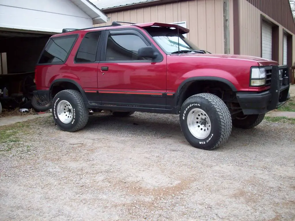

for an idea here is a picture of my truck when it had a 1.5 inch suspension lift (shackles and extended coils) and 31s.
honestly, even with that much of a lift, the 31s are too small. they fit on my truck at stock height perfectly. hope this helps.

Thanks for the pic Four0Sport, IMO the 1.5" lift makes the tires look almost stock-ish. The space between the top of the tires and the bottom of the fenders looks similar to the way my X sits. I'm gonna try to take a pic of it tomorrow and post it up.
