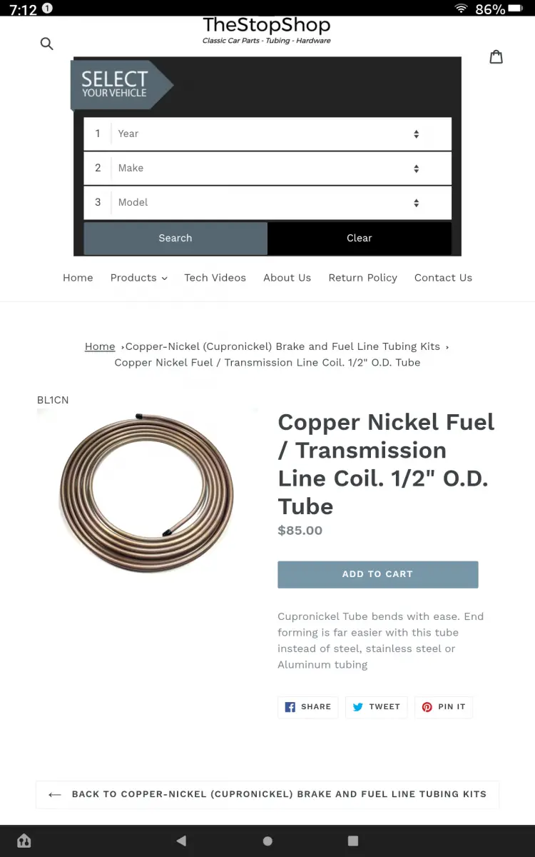

I would recommend 1/2 copper nickel about $79 today price shipped. Easy to work with. You need a 1/2 bender lightweight. The tube is Available from stop shop.
