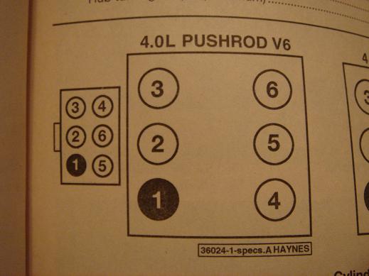

Ok so got a little over excited and pulled all my spark plug wires out at once and wasn't thinking about what position they are supposed to go in and now!!!!! My car sounds like ****! Soooooo, I need to know what order they plug in the distributor so I can put themin the correct way. Please help!!! Pictures would be awesome. and I have the original wires to compare numbers at least.
This is from Haynes manual, shows coil pack to cylinder numbers. Hope this helps.:salute:
